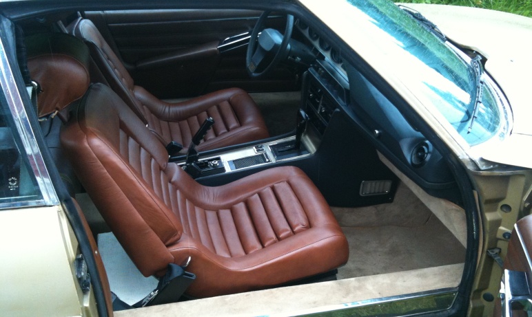

Brake System: CX bremseakkumulatorkule installed after the original varnish.
Interior: New brown leather - front seats.

- The outstanding rear mounted, complete interior in new brown leather - gorgeous.

- Mars: Manual gearbox installed.
- April: The conversion is completed.
- May: Necessary adjustments on the shifting cable / lever - everything works (we think :))
